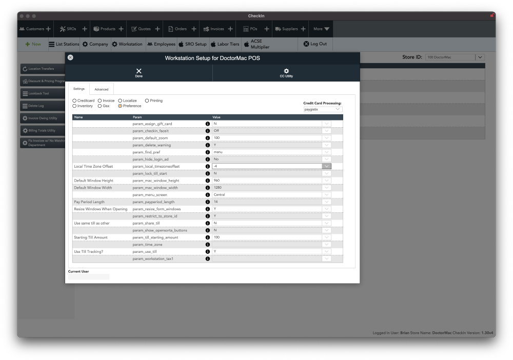

To make sure your Workstation is reporting the proper Date and Time, go to Admin > Workstation Setup > Preference  and select "Local Time Zone Offset." If you click on the "Information" icon, CheckIn will show you a list of geographical locations, and their Time Zone Offsets (from UTC). Enter the number that applies to your location.
Note that you may need to make an adjustment to this setting if you are currently under Daylight Savings Time (DST), and again once your location exits it.
