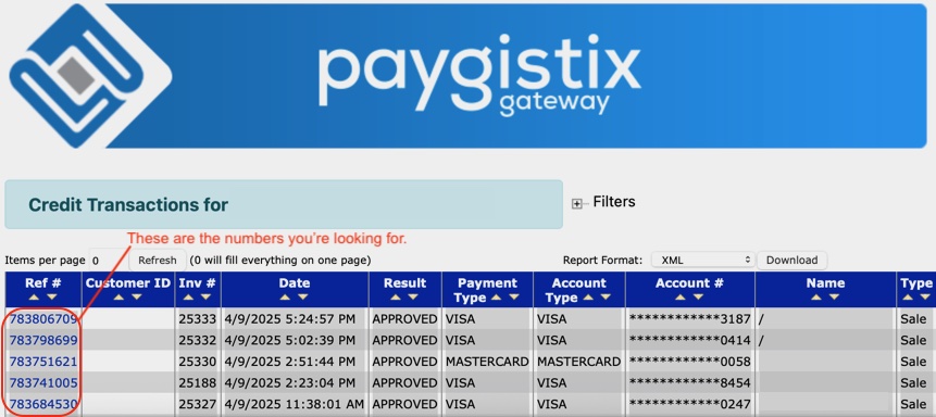

Sometimes, the above steps will not work and you're stuck with a payment on your invoice that has the red hexagon symbol.
When that happens, you will want to click on that button on the payment line and manually enter the Ref # (look it up in your Paygistx portal) into the field. It will update the payment and link it to the correct charge on the Paygistix side.
