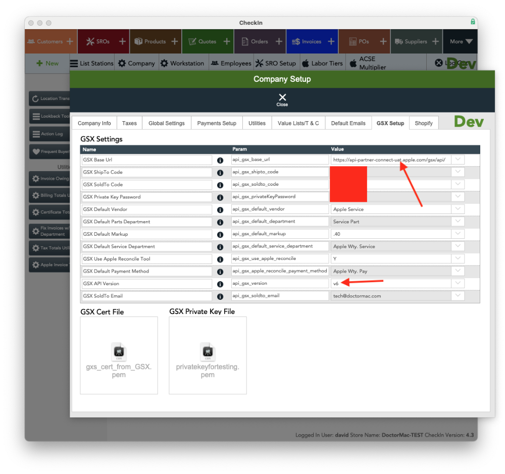

If you are upgrading from Checkin 4.2v1 or earlier, there are a few extra steps that must be taken to ensure that GSX continues to work.
After the update is complete open the admin section of CheckIn and click on Company, then on the new 'GSX Setup' tab.
Your window should be as shown.
Be sure your GSX base URL does NOT have the uat section in the address.
Make sure your 'shipto' 'sold' & 'privateKeyPassword' fields are correct and have no leading or trailing spaces.
Verify you're on version 6 of GSX.
And finally, you can now drag and drop your certificate and private key files to the boxes on this page. This is a major upgrade from the previous way these files were handled.
