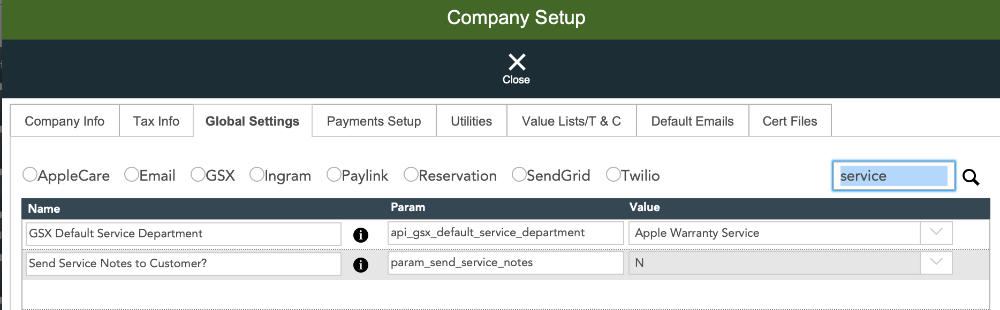

If you would like your SRO timeline to be printed along with the invoice for the customer you need to enable this feature by going to: Admin > Company Setup > Global Settings > then enter "service" in the little search box on the top right of the Global Settings tab.
Change the Value to Y.
Note, all other workstations will have to quit out of CheckIn and go back in to take advantage of the change.
