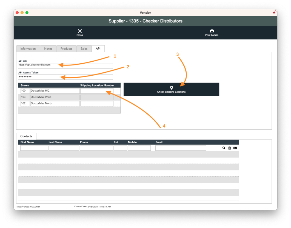

Step 1: click the API Tab and enter in the API URL. It is: https://api.checkerdist.com
Step 2: Obtain your API Access Token from your Checker account. The instructions for that are here:
Login to your Checker Dashboard. Go to the section titled POS DATA. Look for the subsection called POS DATASTREAM. Locate the title that says "YOUR UNIQUE IDENTIFIER" Copy and paste that code into the API Access Token field.

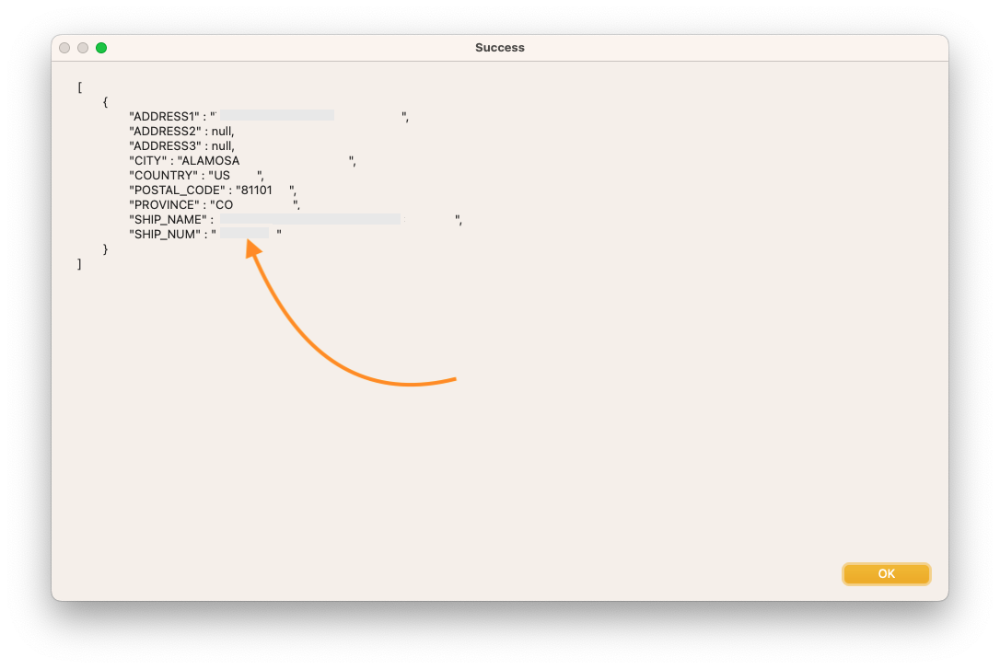

Step 3: You'll need to get your Checker Shipping Location Numbers for each of your stores. To see them, simply click on the Check Shipping Locations
This is what you will see when clicking on the Check Shipping Locations button.
Step 4: Note the SHIP_NUM value and put it into the corresponding field in CheckIn.

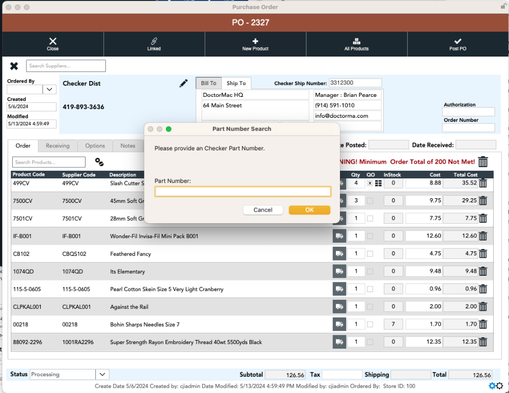

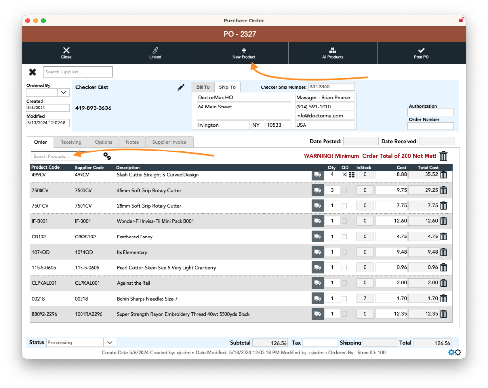

From the Purchase Order Dashboard, create a new PO.
Search for Checker via the Search Suppliers box on the PO. Once Checker is added to the PO, you can begin searching for products supplied by Checker.

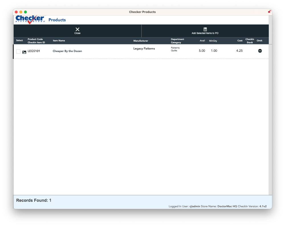

Next, you can add Checker Products to the PO by using the New Product button or the Search Products button.
When using the New Product button, you will be able to enter the Checker Item Number and it will search the Checker API and if found, it will create the Product in the Checker table in CheckIn.

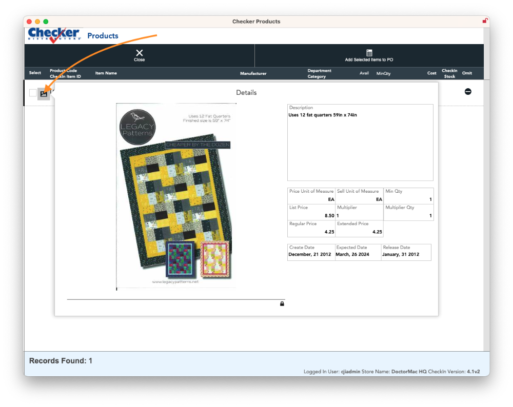

You will then have the option to Add the Product to YOUR CheckIn Inventory and to the PO. Simply click the Select OR click on the Item Name to add it to CheckIn and the PO.
Click on the Image Icon to see details on the product
