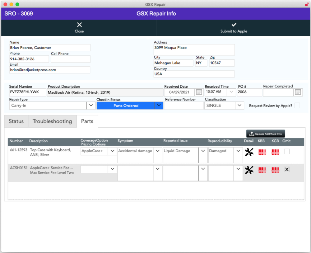

You may need to create the AppleCare+ Service Fee product card in your system -- they will not be listed among the Service Parts that are available with a Parts lookup by Serial Number.
When creating a Repair covered by AppleCare+, the AppleCare+ Service Fee will be added to the SRO and PO. (We collect that fee from the customer, and are billed that fee by Apple.)
Because it's included on the PO, it will also appear under the “Parts” tab when creating a GSX Repair — that information is drawn from the PO associated with the Repair. But as this isn't a tangible part, submitting it as part of the Repair will cause an error.
When creating the repair in the GSX Repair window, click the “Omit” checkbox at the far right to keep it from being submitted as a Service Part. As long as the Coverage and Pricing Options for the other parts are set properly, AppleCare+ coverage will be properly applied.
