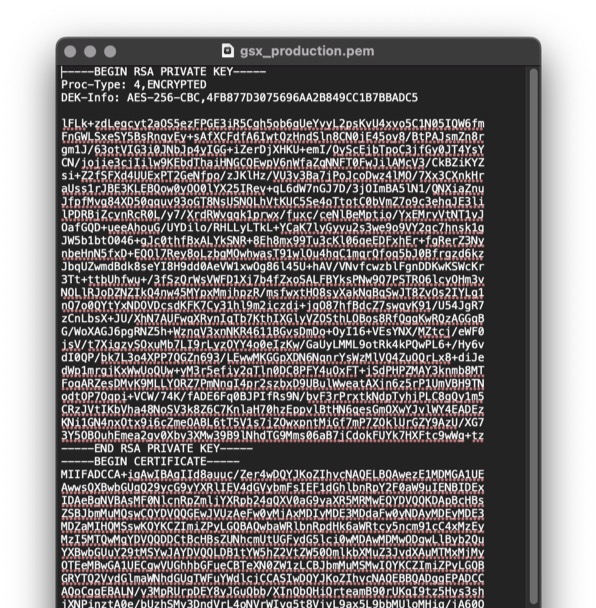

To check the expiration date for your API Certificate (assuming it is in the same location where it was originally installed), use the following Terminal command:
openssl x509 -in /Library/FileMaker\ Server/Data/GSX/gsx_production.pem -text
In the first several lines of the output you'll see the following text:
Validity
Not Before: Jan  2 20:17:07 2022 GMT
Not After : Feb  1 20:17:06 2024 GMT
In the example above, the certificate will expire on February 1, 2024. We will lose access to GSX through CheckIn if a replacement certificate is not in place.

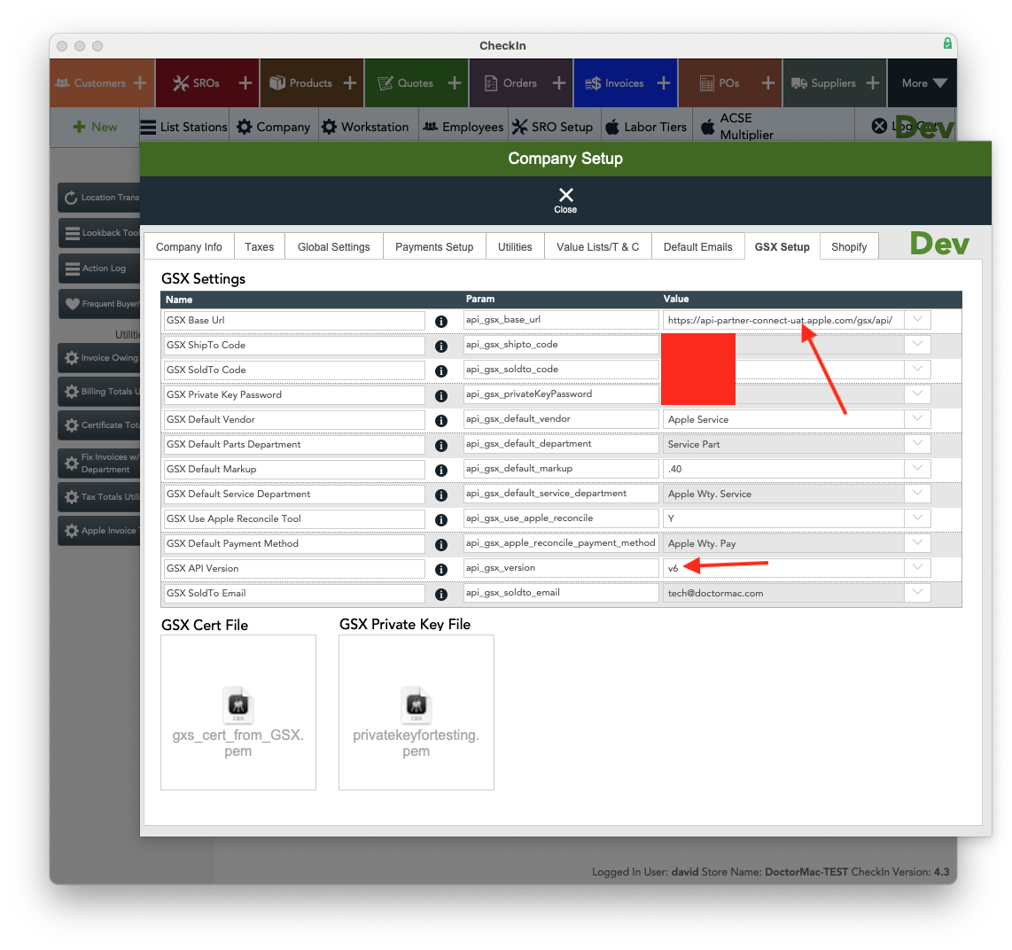

Open the admin section of CheckIn and click on Company, then on the new 'GSX Setup' tab.
Your window should be as shown.
Be sure your GSX base URL does NOT have the uat section in the address.
Make sure your 'shipto' 'sold' & 'privateKeyPassword' fields are correct and have no leading or trailing spaces.
Verify you're on version 6 of GSX.
And finally, you can now drag and drop your certificate and private key files to the boxes on this page. This is a major upgrade from the previous way these files were handled.
