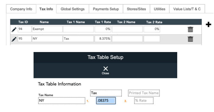

 4  Company Setup Stuff: Tax Info
Be default there should be two tax IDs listed. The first one should be called Exempt and the second one needs you to give it a name like Tax and a Tax1 & Tax2 name if necessary. When you click on the Tax 1 Rate field it will open up a Tax Table Setup window to enter your tax amount - Please enter as such: .08375
*In the USA & AU only one tax rate breakdown is typically needed for state and local taxes to be shown. For our Canadian customer, some provinces need to show GST and PST separately and can do that easily in this Tax Table Setup window.
(Please read the Please Note section for more information about how this prints)
If you are using your CheckIn server for multiple store you will need to make sure tax is set correctly for each location.

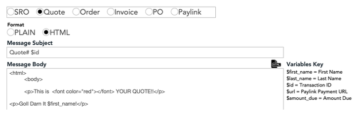

 10  Company Setup: Default Emails
Under this tab you will have the opportunity to setup your default subject and/or default email message body when sending out emails via any of of the listed options. The variable key helps you to customize your message.
