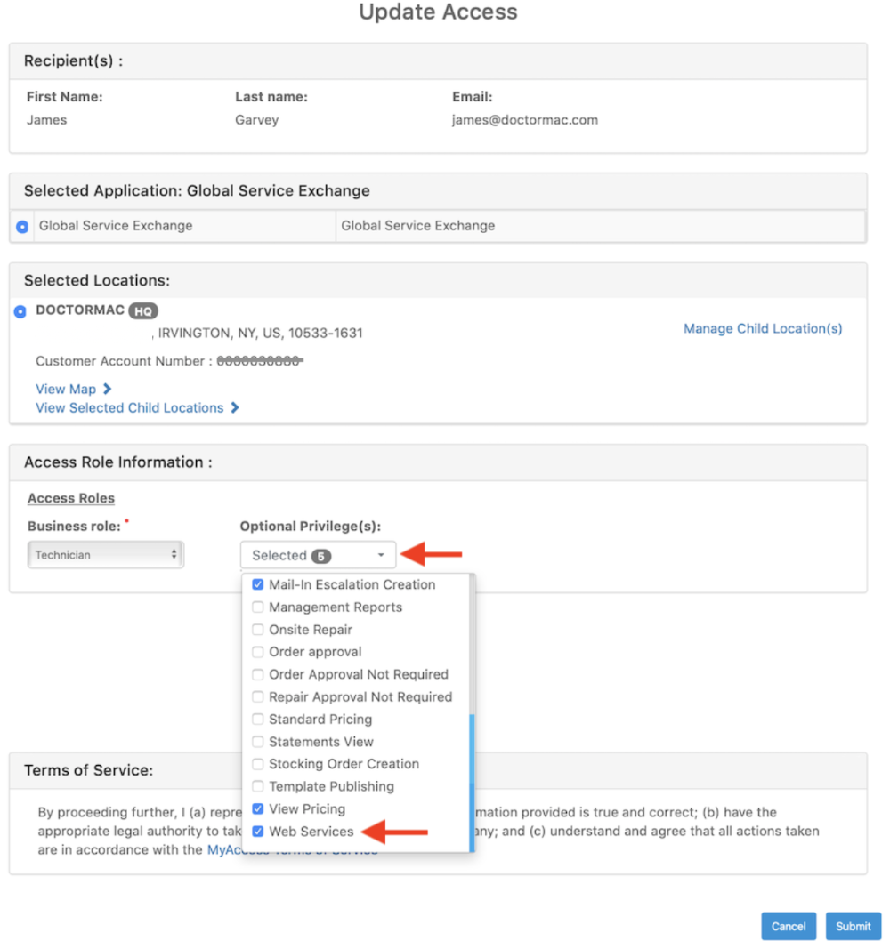

In order to ensure smooth onboarding for CheckIn’s GSX API integration, you need to make sure each Technician who has GSX access also has Web Services activated as well.  In order to confirm this or in order to active this, please do the following. (see image below)
  • Log into your My Access account at:  https://myaccess.apple.com
  • Go to My Team tab at the top menu bar section
  • Click on the Switch View button at the top right of the screen
  • Once you locate the technician choose the little pencil icon under the column titled “Manage Access” for the “Technician Role”
  • In the “Access Role Information” section halfway down the screen, choose the Optional Privilege(s) menu and make sure Web Services has a check!
  • Click Submit
Dealing with Apple GSX and the security around it and how each user gets access can be a bit complicated. In order to make the GSX setup process as smooth as possible within CheckIn, it’s important that each technician who accesses GSX has the proper credentials. Even though they are able to use GSX via a browser doesn’t ensure they will be able to use the GSX APIs via CheckIn necessarily. You will need to confirm that each technician’s Apple ID has the ability to use the GSX API by logging into your Apple “My Access” account and make sure Web Services are active for each user!
