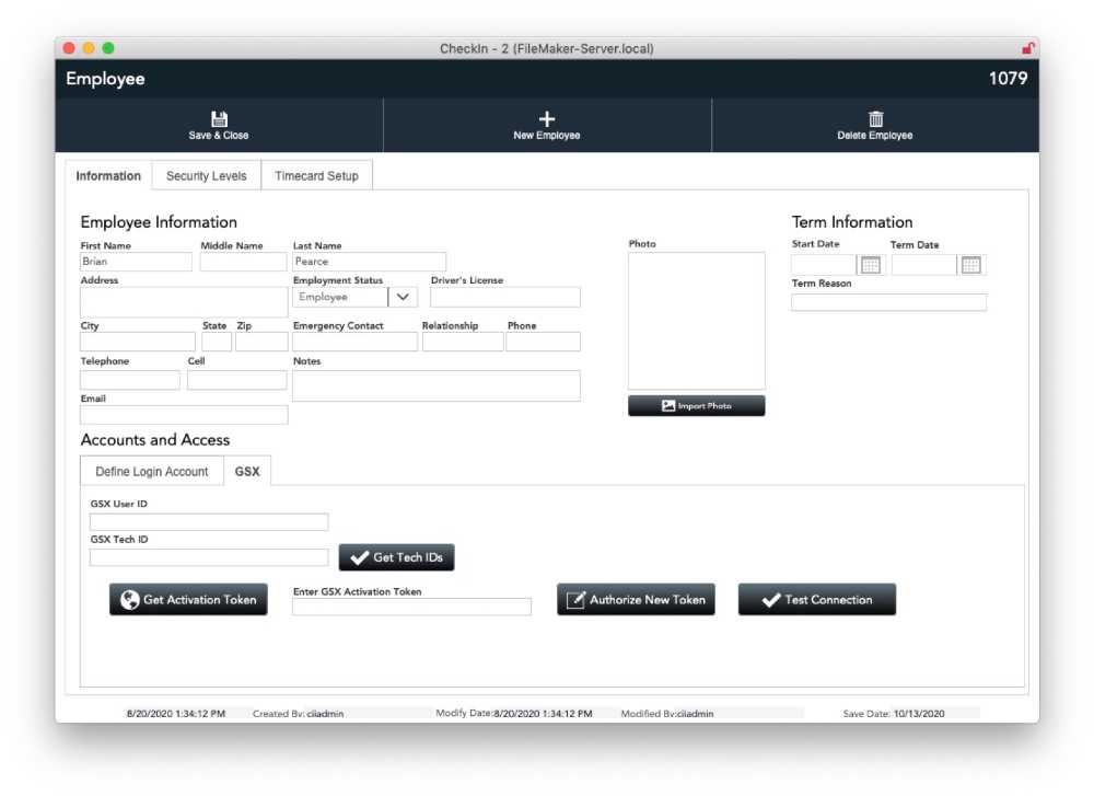

To add GSX Access for users in CheckIn: In the Taskbar, click the "More" button. Select "Admin," and then the "Employees" tab. Click on the triangle next to the employee. In the "Employee" window, select the "Information" tab, and then the "GSX" tab. Enter the Apple ID and Tech ID for the User.
Make sure the User is successfully logged into GSX on the web. Click the "Get Activation Token" button. Copy the token from GSX on the web, and paste it into the field next to the "Get Activation Token" button. Press the "Authorize New Token" button, and then the "Test Connection" button to confirm that GSX Access is working.

In the event that you need to renew your GSX access in CheckIn, or if you see a “Call Not Authorized” error message when attempting to connect to GSX: In the SRO Dashboard, click "More," and from the drop-down menu, select "Get New Token." (You can also do this through any SRO, by clicking on the small ‘gear’ icon in the lower right hand corner.) In the small pop-up window, click the “Get a New Token” button. A new window will appear.
If this is a troubleshooting step, you can click the “Test Connection” button, to establish that CheckIn has a working connection with GSX.
Note the GSX Tech User Name. If you need to retrieve a new Activation Token, click the “Get Activation Token” button. If the GSX Tech of record in CheckIn is already logged in to GSX on the web, a browser window with a new API Token will appear. (If not, that User will be prompted to log into GSX.) In the browser window, click the “Copy to clipboard” button, and paste that information into the “Enter GSX Activation Token” window in CheckIn.
Click the “Authorize New Token” button. You should see a dialog box indicating success. Click the “Test Connection” button, to establish that CheckIn has a working connection with GSX.
