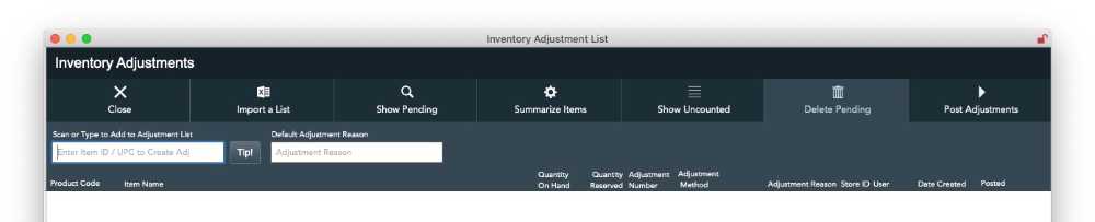

To begin the Inventory process in CheckIn, go to the "Products" dashboard, click on the "More" button in the Task Bar, and select "Adjust." This will open the "Inventory Adjustments" window.
Important: before proceeding, click the "Delete Pending" button to remove any existing records.

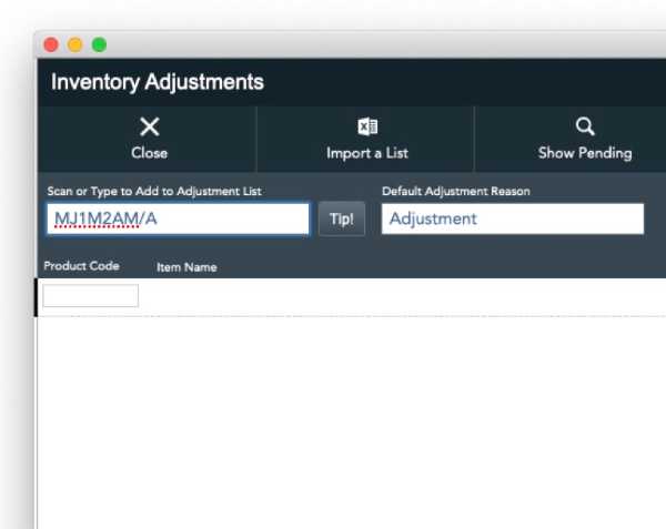

To add an item to the "Inventory Adjustments" list, use the "Scan or Type to Add to Adjustment List" field in the top left. You can type in an Item ID, Supplier Code, UPC Code, or you can scan a Barcode. Items will be added to the list. You also have the option of adding an "Adjustment Reason" at this time, or the default will be used.
