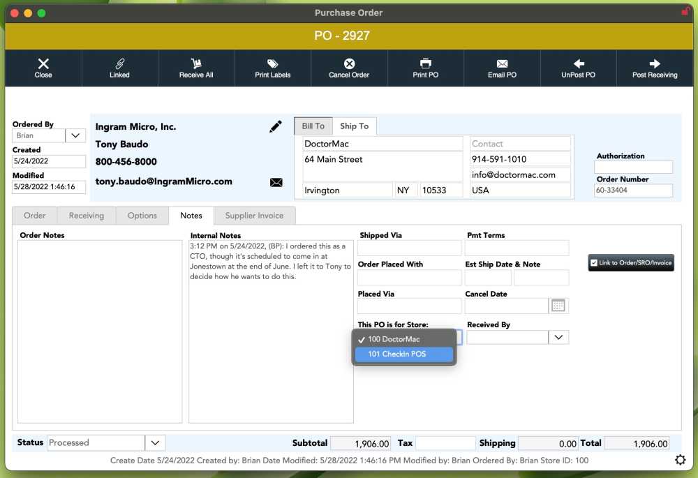

Purchase Orders can be assigned to different different store locations (under Notes > This PO is for Store
, but this cannot be changed once items have been added.

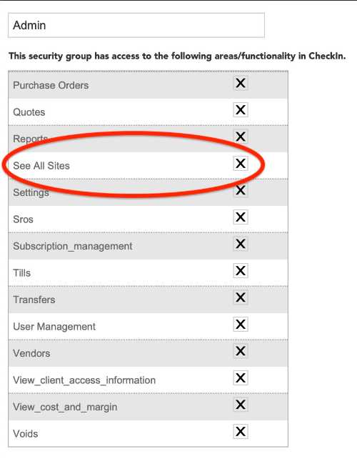

To use the Multi-Store feature, you'll want to have the "See All Sites" privilege enabled. This will enable you to search multiple locations.

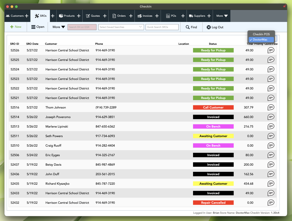

The SRO Dashboard includes a function that will allow you to view SROs created in different store locations, using the drop-down menu at the top right of the SRO dashboard. Note that this only changes the listing of SROs -- changing the location from the SRO dashboard will not allow you to create an SRO from a different store location than the workstation is set for.

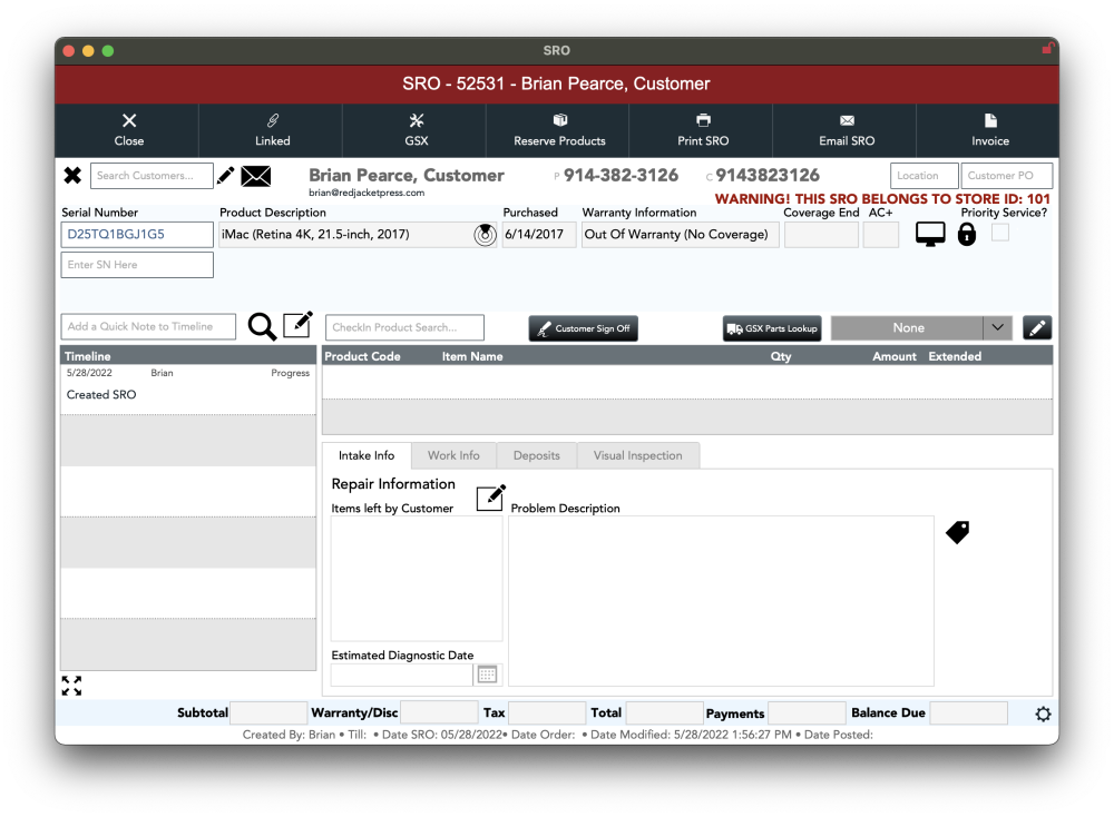

When viewing an SRO from a different Store Location, you'll see a warning message in the top right part of the SRO. Proceed with caution: any changes to the SRO will apply to the Store Location where the SRO was created.
(Note that the "Location" field in the top right of the SRO window is editable, and has no bearing on the Store Location.)

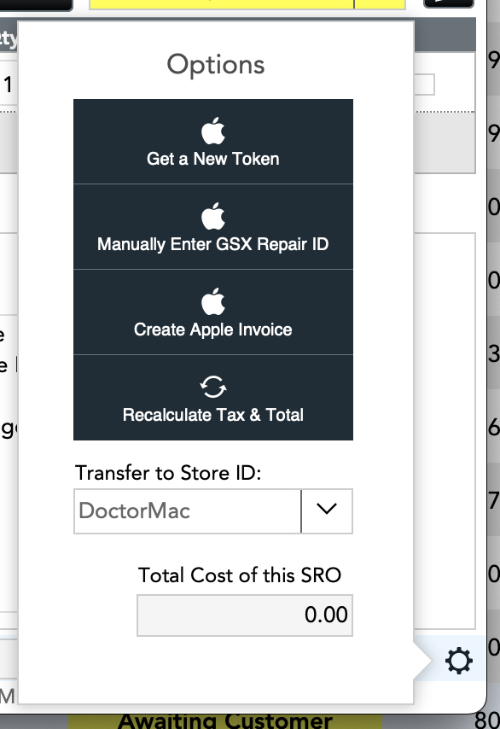

To move an SRO to a different Store Location, click on the "Gear" icon in the lower right hand corner of the SRO window, and use the "Transfer to Store ID" tool. Note that this will move the SRO, but it will not move the PO. Parts will be sent to the location where the GSX Repair was originally submitted.
