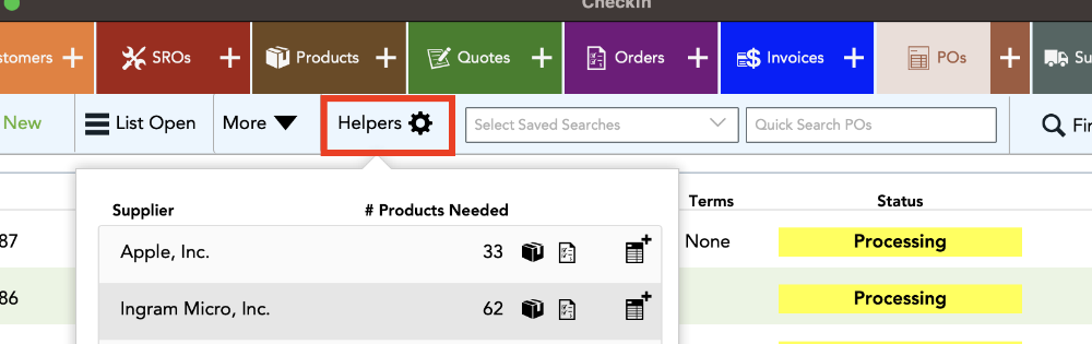

Navigate to the PO Dashboard screen. From there, select the Helpers button at the left of the screen. Initially, it may not list many (or any) suppliers here. However, as you sell items and set up your minimum and maximum quantities, this list will become populated with suppliers that have products that need to be reordered.

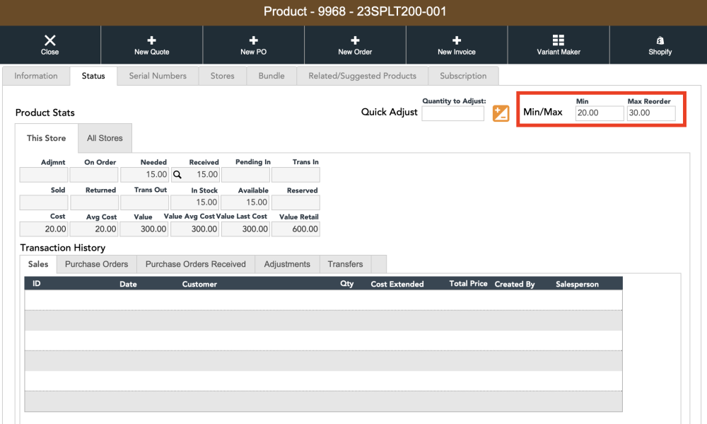

To set Minimum or Maximum stock quantities for a product, navigate to a Product Card. Click the Status tab at the top, and input your desired values in the Min/Max Reorder fields.
How to Use the Minimum and Maximum Fields
Minimum - This field sets a minimum level or floor quantity for this product. Once your current In Stock quantity for the product falls below this level, it will be marked for Reorder in the Helpers section on the PO Dashboard. The supplier this product is ordered from will show up in the list, along with how many products are needed to bring it back to the minimum level that was set.
Maximum - This field works alongside the minimum level to set the quantity that will be ordered once the quantity for the product falls below the minimum level. This can always be changed manually once you create the PO, but the maximum determines what number is ordered there by default.

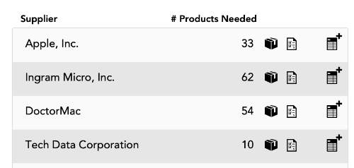

Once you have set up your min/max levels eventually you will reach a point where you need to reorder your items. Navigate to the Helpers Tool to view the Suppliers that have products needing reordering.
Next to each Supplier, you will see the number of products needed and also three buttons. From here, you have a few different options. You can use the first button from the left to view the products that need to be re-ordered. That screen will allow you to create a Purchase Order with the items of your choosing. The middle button will allow you to view all the open Purchase Orders for this Supplier. Lastly, the button on the right will create a Purchase Order and add all the items that need to be reordered to that PO.
