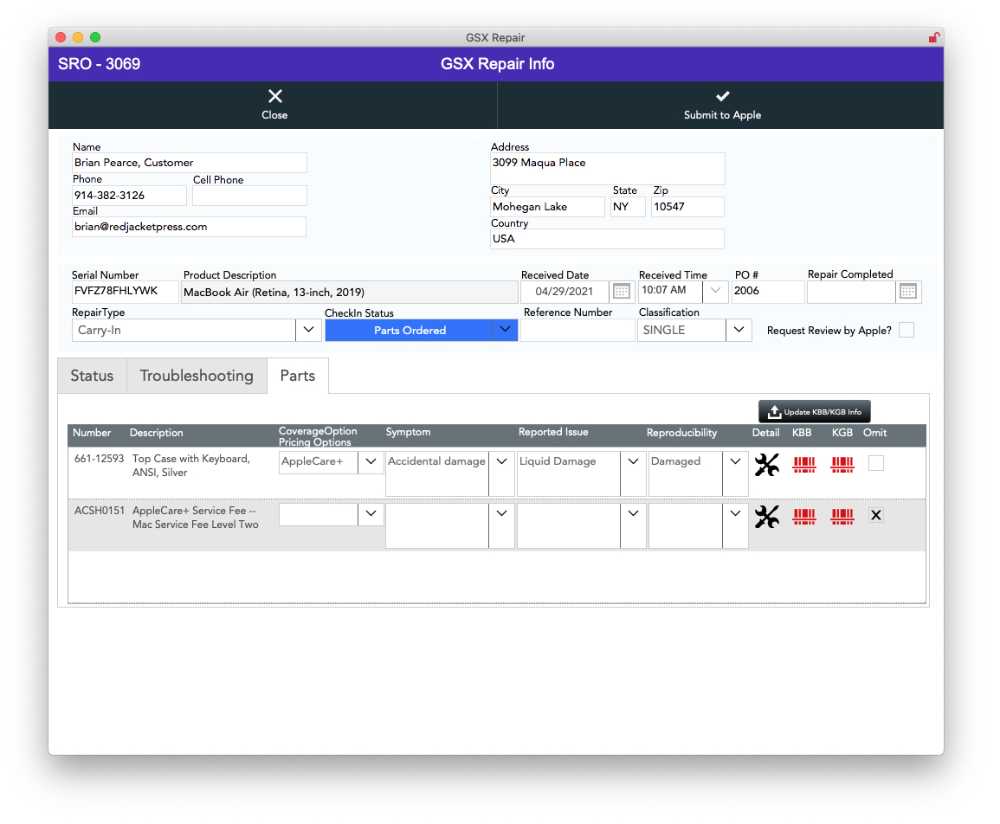

Note that you may need to create or import the AppleCare+ Service Fee items in your system -- they will not be listed among the Service Parts that are available with a Parts lookup by Serial Number.
When creating a Repair covered by AppleCare+, the AppleCare+ Service Fee will be added to the SRO and PO. (We collect that fee from the customer, and are billed that fee by Apple.) Because it's included on the PO, it will also appear under the “Parts” tab when creating a GSX Repair -- that information is drawn from the PO associated with the Repair. But as this isn't a tangible part, submitting it as part of the Repair will cause an error.
When creating the repair in the GSX Repair window, click the “Omit” checkbox at the far right to keep it from being submitted as a Service Part. As long as the Coverage and Pricing Options for the other parts are set properly (see the screenshot below), AppleCare+ coverage will be properly applied.

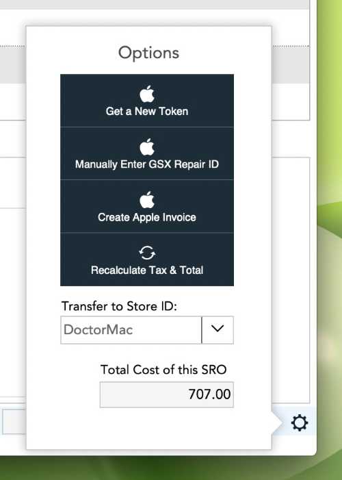

Transfer SROs between locations
Multi-Store Users have the option to transfer an SRO to a different location -- that feature is under the "Options" menu, the "Gear" icon in the bottom right of the SRO Window. Note that there are a few limitations to the feature:
You can transfer an SRO to another location, but you cannot transfer it from another location. (Once it's been moved, a User at the other location would need to transfer it back.)

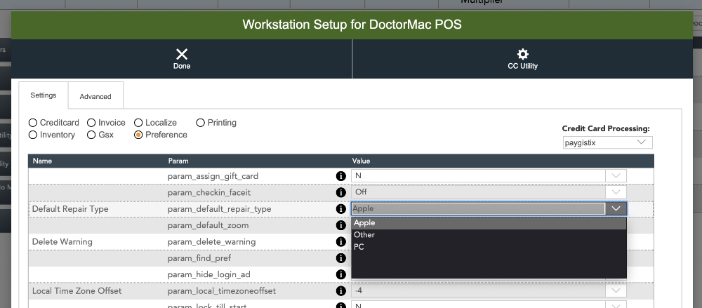

To make sure your Workstation is reporting the proper Date and Time, go to Admin > Workstation Setup > Preference and select "Local Time Zone Offset." If you click on the "Information" icon, CheckIn will show you a list of geographical locations, and their Time Zone Offsets (from UTC). Enter the number that applies to your location.

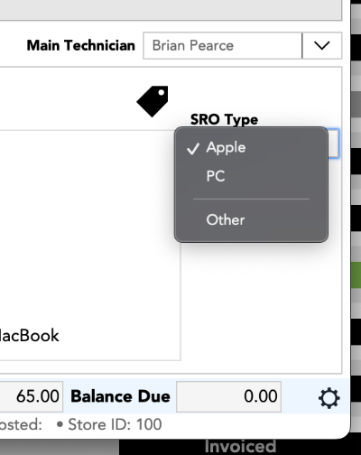

More recent versions of CheckIn have the ability to change the Repair Type, to allow for repairs to be created with a non-Apple product (and will not automatically query GSX for a Serial Number lookup). This can be set in the "SRO Type" drop-down menu, at the far right of the SRO.
To set the Default Repair Type, go to Admin > Workstation > Preference > param_default_repair_type, and make a selection from the options in the drop-down menu.
