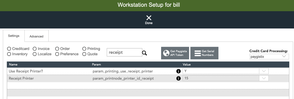

The default print option in CheckIn is to a standard 8x11 invoice.  To activate receipt printing in order to print to a Star TSP receipt printer you need to go to Admin> Workstation>
At the setting tab search for "receipt" as shows below and select Y  for "Use Receipt Printer? and add the workstations printer ID in the field below.
Once this is setup, you will see a new button called  Print Receipt at the top of the invoice screen and on the POS screen if you are using that.
