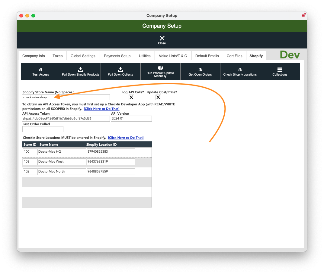

Next, navigate to the company setup screen. Insert your store name in the Shopify Store Name field, located in the Shopify tab.
