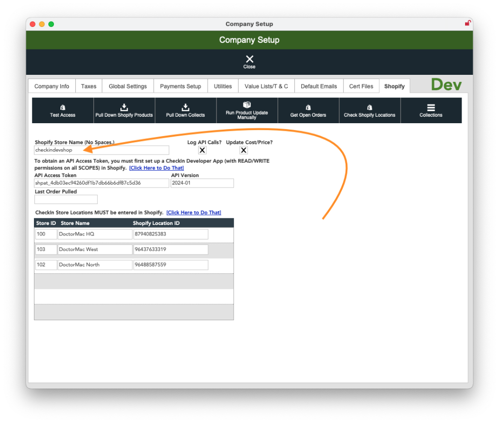

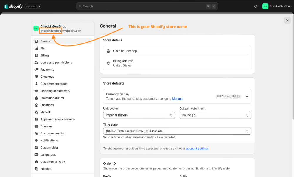

Next, navigate to the company setup screen. Insert your store name in the Shopify Store Name field, located in the Shopify tab.
Then, return to Shopify to continue the configuration.

- Go back to CheckIn's Company Settings section and go to the Shopify tab. Paste the token into the API Access Token field.
- Enter 2024-01 in the API version field. (see screenshot above for example)
- If the Log API Calls checkbox is selected, click to uncheck it. This feature is used by the CheckIn development team to debug any issues that may arise with Shopify.
- If you want the Cost and Price of Products updated in Shopify any time you change them in CheckIn, make sure the Update Cost/Price checkbox is checked.
- Click on Test Access. Expand the pop-up box to see the full message. You should receive a pop-up with information about your store, such as the store name, address, etc. If you receive an error please contact Checkin Support.

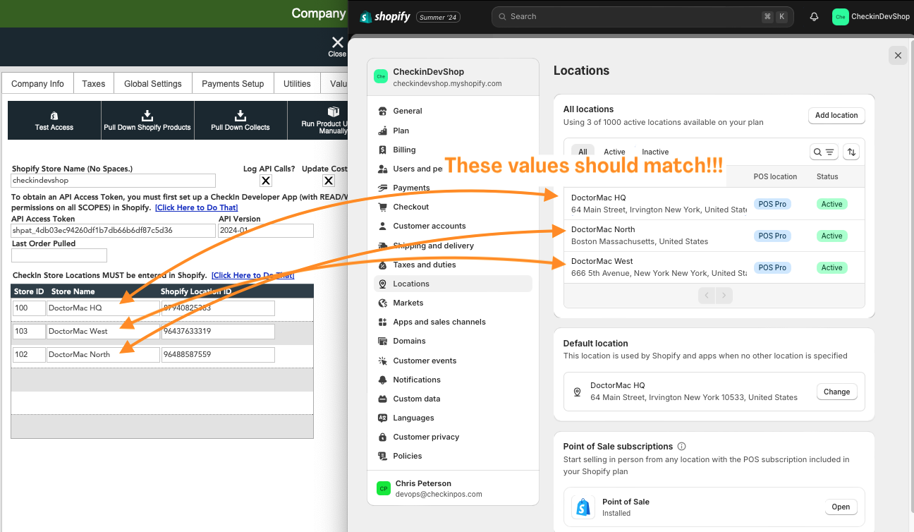

- Next, ensure that each of your CheckIn Store Locations match the locations specified in Shopify by clicking on the Click Here To Do That button in CheckIn.
