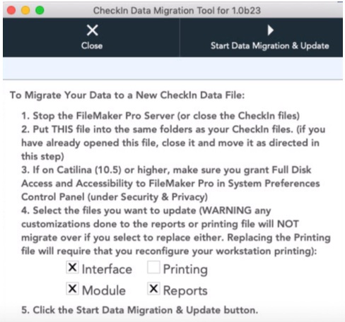

Step 6. The CheckIn Data Migration Tool will bring up the window seen below and will have the appropriate checkboxes pre selected for you. *(At certain times we may tell you to also check off the printing files.)
Step 7. Click “Start Data Migration & Update” ( This will trigger the backup of your files, the installation of new files and it will also trigger the Terminal app to migrate your data to the new data file.)
*The check boxes will be pre-selected for you so please do not change what you see checked off unless otherwise instructed.
