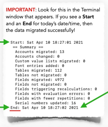

Step 8. You will then see a small Notice window pop up. Before clicking on OK to close it, you will need to observe what is shown on the terminal window that opens up during this upgrade process.
Once you see that the Data migration is completed (where the last line of the terminal window says End:), you can then click OK on the Notice window:
