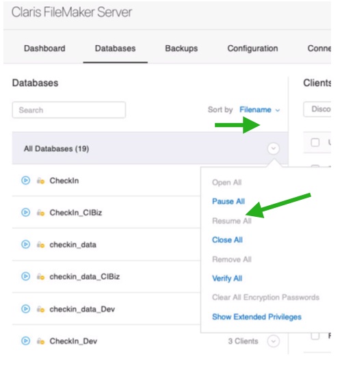

Step 2. Go to the Databases tab and Close All the databases by clicking on the down arrow icon in the grey All Databases section as illustrated to the right and then chose Close All.
  • Once the databases close - the little blue circle icons with the triangle in the middle will no longer be blue (they go to red for a bit then to grey when the databases are finally closed.)

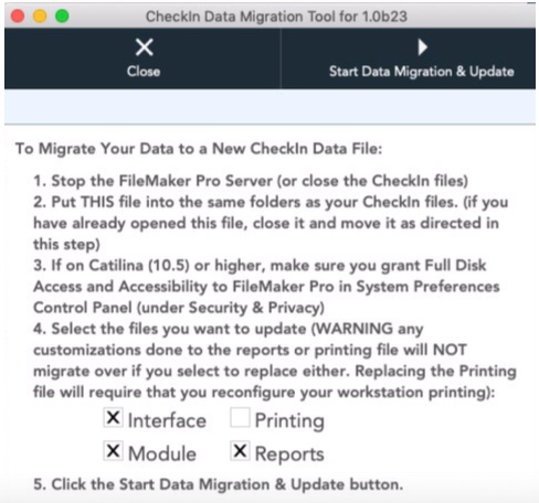

Step 6. The CheckIn Data Migration Tool will bring up the window seen below and will have the appropriate checkboxes pre selected for you. *(At certain times we may tell you to also check off the printing files.)
Step 7. Click “Start Data Migration & Update” ( This will trigger the backup of your files, the installation of new files and it will also trigger the Terminal app to migrate your data to the new data file.)
*The check boxes will be pre-selected for you so please do not change what you see checked off unless otherwise instructed.

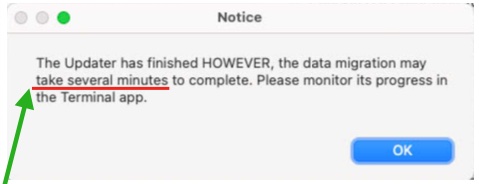

Step 8. You will then see a small Notice window pop up. Before clicking on OK to close it, you will need to observe what is shown on the terminal window that opens up during this upgrade process.
Once you see that the Data migration is completed (where the last line of the terminal window says End:), you can then click OK on the Notice window:
Please be patient and make sure you see the process End before moving forward!

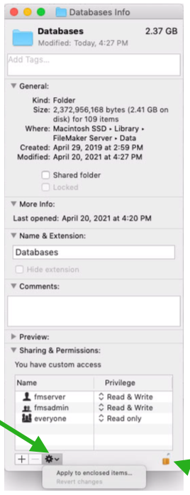

Step 10. IMPORTANT: You must set the correct permissions to your new CheckIn files in order for FileMaker Server to host them. First click the Lock item at the bottom right then enter your servers system password.
Set Permissions by getting Info on the Database folder you were just in and simply choose “Apply to enclosed items” as pictured in the image to the right:

Go to the Databases tab and Open All the databases by clicking on the down arrow icon in the grey All Databases section as illustrated to the right and then chose Open All. This will open all the CheckIn databases you closed earlier and the little circle icons with the triangle in the middle will turn blue again.
