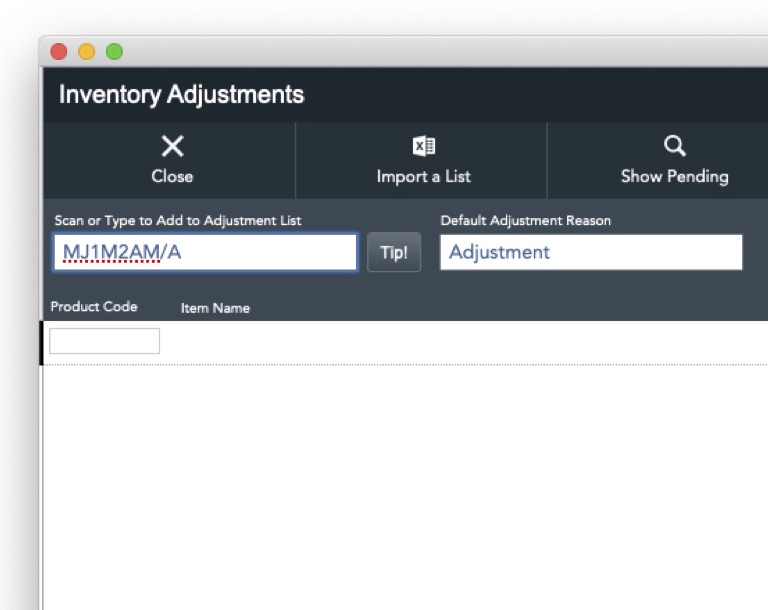

To begin the Inventory process in CheckIn, go to the "Products" dashboard, click on the "More" button in the Task Bar, and select "Adjust." This will open the "Inventory Adjustments" window.
Important: before proceeding, click the "Delete Pending" button to remove any existing records.
To add an item to the "Inventory Adjustments" list, use the "Scan or Type to Add to Adjustment List" field in the top left. You can type in an Item ID, Supplier Code, UPC Code, or you can scan a Barcode. Items will be added to the list. You also have the option of adding an "Adjustment Reason" at this time, or the default  will be used.
When each item is added to the list, a small magnifying glass icon will appear to the left of each Item Name -- click on it to open the Item's Product Card.
(Note that the items you add to this list will remain here -- even if you close this window -- until the inventory count is updated.)
