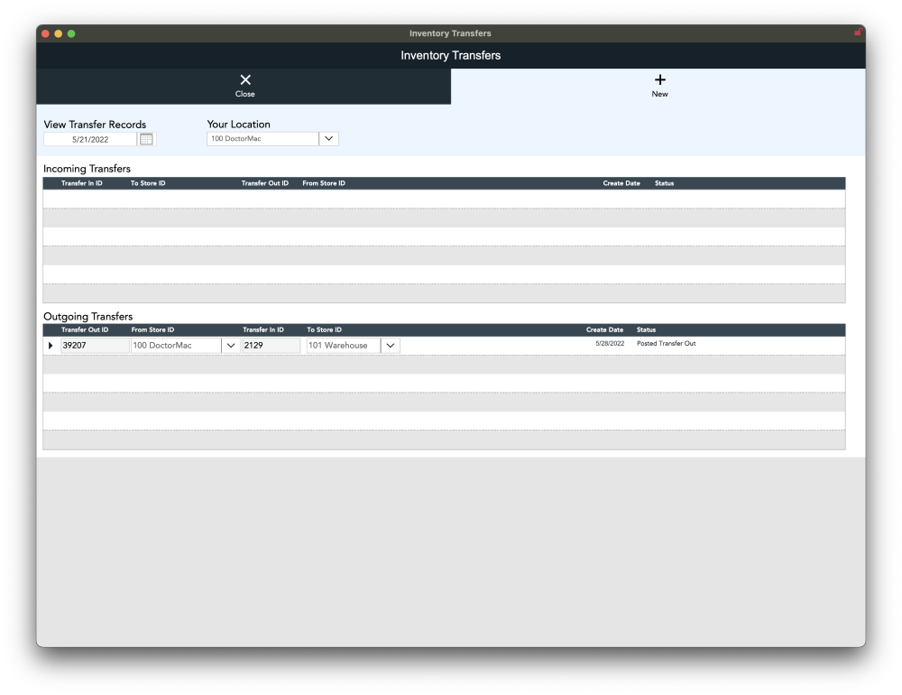

Next, you'll see a list of both Incoming and Outgoing Transfers. If any inventory has been transferred to the current Store ID, you'll see those transactions listed here.
Can we post incoming transfers from this view?
To complete the process, switch to the location where the Inventory was to be transferred to, in Admin > More > Store ID. Use the "Location Transfers" button on the left to bring up the list of pending transfers.
