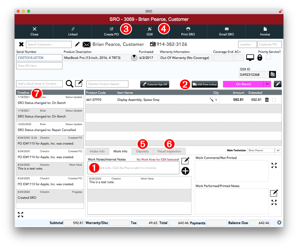

In the SRO Window:
- In “Work Notes” (under the “Work Info” tab), create and add a note to be submitted to Apple as a Technician Note. Click on that note in the list of “Work Notes,” and check the box that says “Send to GSX.” (Note: A repair cannot be submitted without both a Technician Note and a Customer Reported Symptom.)
- Click the “GSX Parts Lookup” button to bring up a list of parts associated with the unit in repair. You can use the “Filter Parts List” field (at the top left) to search for a specific part by description or product code. (If you need to refresh the listing, click the “Clear All” button at the top right of the "Parts List" window.)
- Click the “Plus” to add the part to the repair. (If the part is not already in CheckIn, a Product Card will be created, and the product can be added from there.) A pop-up window will give you the opportunity to select the appropriate pricing option (Stock Price, Exchange Price, Battery Only Price, Part Required for Repair or Covered Under Warranty), and the part will be added to the repair. You can add additional parts using the same sequence.
- Once all parts have been added, check the check boxes to the right of each product to be ordered from Apple. Click the “Create PO” button in the Dashboard to create a Purchase Order. Once you’re content that parts and pricing are correct, you can close the PO window. (The PO will automatically be posted when the repair is successfully submitted to Apple.)
- Click the “GSX” button in the Task Bar to create a GSX Repair Ticket. Note that information from the SRO, as well as the associated PO number, are automatically added to the ticket.

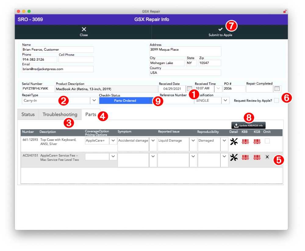

In the GSX Ticket:
- Enter the Received Date and Time. You can type this information, or use the date picker and drop down functions.
- Make sure the “Repair Type is set appropriately. (For many repairs, it will be “Carry-In.”)
- Under the “Troubleshooting” tab, enter the Symptom, Reported Issue, and Reproducibility. (The Priority, Type and Order fields will likely be automatically chosen by CheckIn.)
- To the right, in the “Troubleshooting” tab, you'll see a small '?' icon -- click on that to check for any questions that need to be answered for the Repair to be successfully submitted.
- Under the “Parts” tab, select the Coverage Option, Symptom, Reported Issue, and Reproducibility for each part. When you select a "Coverage Option," that selection will propagate to each of the other listed parts.
- If you need to remove a part, click on the small ‘Trash Can’ icon to the right of the part. (Note: this will also remove the part from the PO. To prevent a part from being submitted to GSX, use the "Omit" checkbox.)
- For AppleCare+ repairs, the AppleCare+ Service Fee will appear under the “Parts” tab, but this should not be included. Click the “Omit” checkbox at the far right to keep it from being submitted.
- If you need to Mark the Repair for Review, check the “Request Review by Apple” box. (GSX offers the opportunity to check pricing or to save a Repair before submission only in the web interface — when in doubt, Mark the Repair for Review.)
- When you do this, you'll need to create a "Work Info" entry (in the SRO window), and check the box that says "Review Request Note," so the note is submitted with the GSX Repair.
- Once you’re content that everything is correct, click “Submit to Apple” button along the top of the window to send the repair. It will return a GSX ID (or Repair Number) and the cost of repair, and add this information to the “Status” tab, and to the “Timeline.” If you click on the small ‘spyglass’ icon next to “GSX ID,” it will open the repair in GSX.
