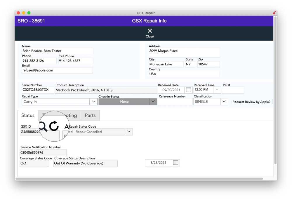

Cancelling and Resubmitting a GSX Repair
In the event that you need to cancel and resubmit a new GSX Repair under the existing SRO: once the previous GSX Repair has been cancelled in GSX, a small ‘cycle’ icon will appear to the right of the ‘spyglass’ icon (next to “GSX ID” in the “Status” tab in the GSX Ticket.). Click on this to clear the previous GSX Repair details, and you will be able to set up and submit a new GSX Repair. (Note that this icon will only be visible if an existing GSX Repair submitted through CheckIn has been cancelled.)
