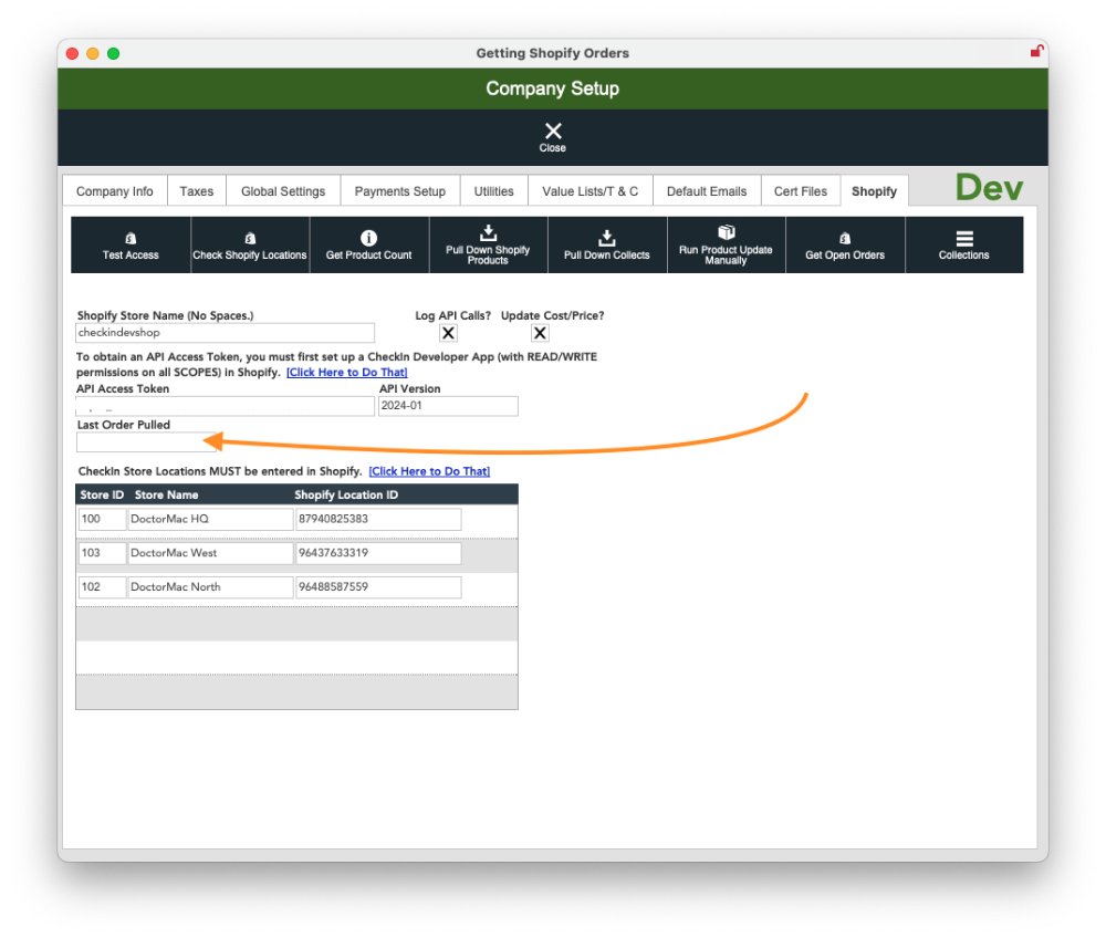

Next, navigate to the company setup screen. Insert your store name in the Shopify Store Name field, located in the Shopify tab.
Then, return to Shopify to continue the configuration.
You must now create a CheckIn Developer App within Shopify to obtain an API Access Token by doing the following:
  • In Shopify, go to the Settings page. Click on Apps and Sales Channels.
  • At the top right of this section, click on Develop Apps.
  • Click the Create An App button. Enter the name CheckIn and then click Create App.
  • You should now be in the App Development -> CheckIn App screen
  • Click on the Configuration tab.
  • Click on the Configure button for the Admin API Integration.
  • Now select EVERY access scope available. There will be about 38 to click on. When done, click on Save.
  • Navigate to the API Credentials tab and click the Install App button you see in the first section called Access Tokens.
  • Click the Install button on the window that pops up.
  • Now in the Admin API Access Token section at the top, click Reveal Token Once in order to see your token. You can only reveal this token ONCE. If you do not copy it the first time you reveal it, you won't be able to see it again. This will result in you having to repeat the steps above.
  • Copy the token.
  • Go back to CheckIn's Company Settings section and go to the Shopify tab. Paste the token into the API Access Token field.
  • Enter 2024-01 in the API version field. (see screenshot above for example)
  • If the Log API Calls checkbox is selected, click to uncheck it. This feature is used by the CheckIn development team to debug any issues that may arise with Shopify.
  • If you want the Cost and Price of Products updated in Shopify any time you change them in CheckIn, make sure the Update Cost/Price checkbox is checked.
  • Click on Test Access. Expand the pop-up box to see the full message. You should receive a pop-up with information about your store, such as the store name, address, etc. If you receive an error please contact Checkin Support.
  • Next, ensure that each of your CheckIn Store Locations match the locations specified in Shopify by clicking on the Click Here To Do That button in CheckIn.
Make sure that you have a matching location in Shopify for each location you have in CheckIn.
Click on the Check Shopify Locations. If all is setup correctly, you will see that Shopify Location IDs are now present in CheckIn
Once all of that is populated, you have completed the first step of your Shopify Integration. Next, you will handle pulling down your products and activating your Shopify sync. Please reach out to CheckIn support before beginning the next step to ensure the pulldown is as smooth as possible.

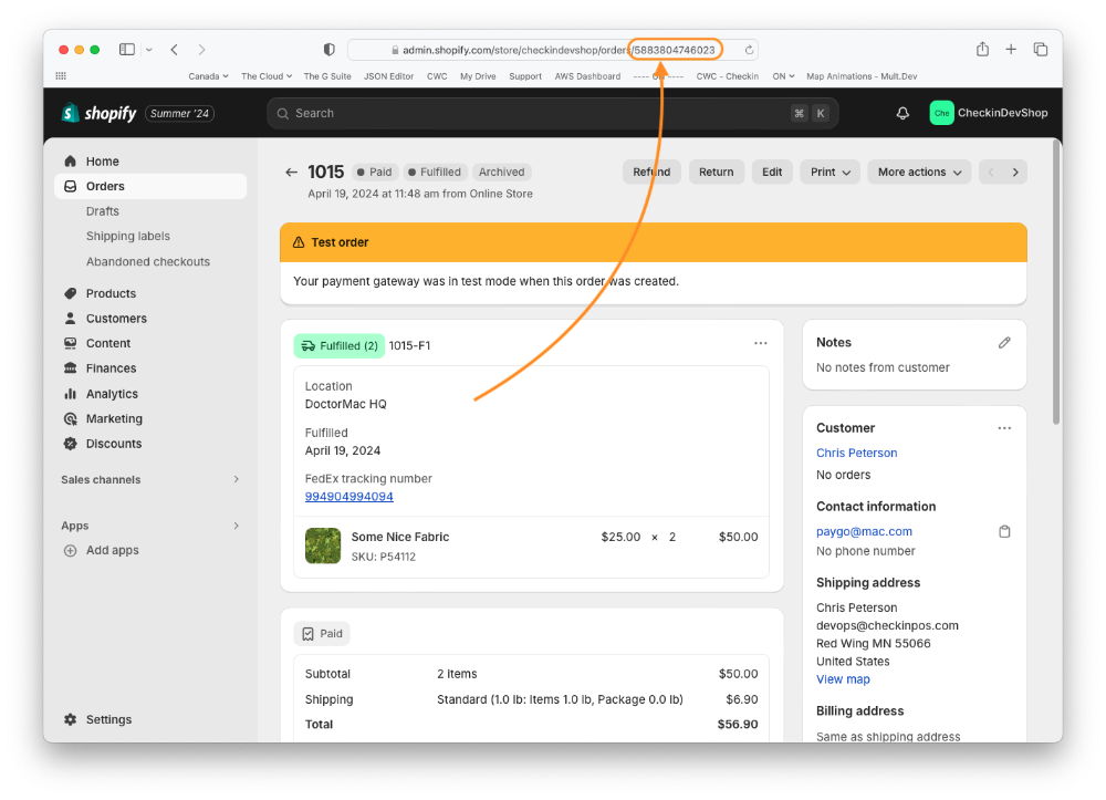

IMPORTANT - If you are integrating a Shopify store that has been active, you need to specify the Last Order Pulled in the Shopify Settings. To get the last order id that was pulled, you need to login to Shopify, go to orders and click on the most recent order.
When you do this, the url at the top of your browser will reveal the order id. Please see image below:
Copy this number and paste it into the Last Order Pulled field in CheckIn. See image below:

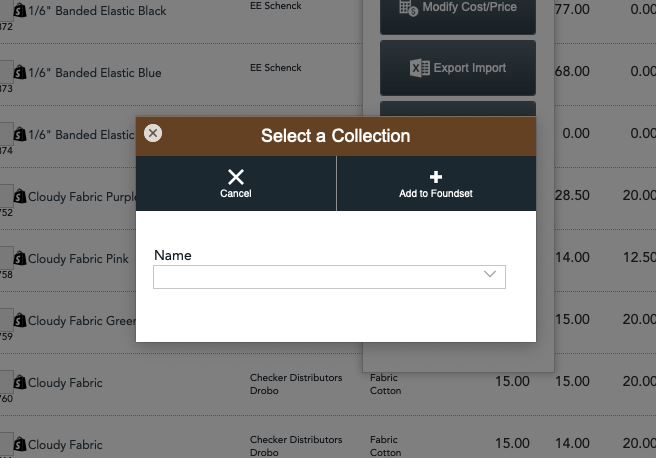

Adding Multiple Products to a Collection

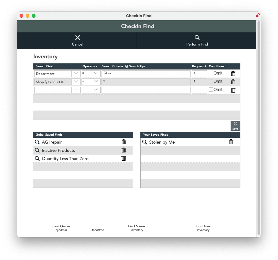

There is a super powerful way to add multiple products to a Shopify Collection. To do this, simply perform a search to find the products you want to add to a collection.
For Instance, find all Products that are in the Fabric Department and are on Shopify:
After performing the Find, you will have a list of Found Records.
Click on Options > Assign Foundset to Existing Shopify Collection
You will then be presented with a window where you can select the Collection.
When you select the Collection and click the Add to Foundset, CheckIn will go through each product record in the foundset and add the collection. These products will then be flagged to update on Shopify.
Please allow up to 15 minutes for you to see the changes on Shopify.

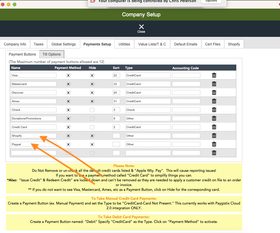

If you want to see Shopify and/or PayPal payments in your End of Day report, please add those as payment buttons. Example:
