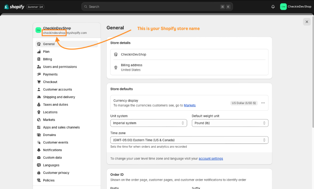

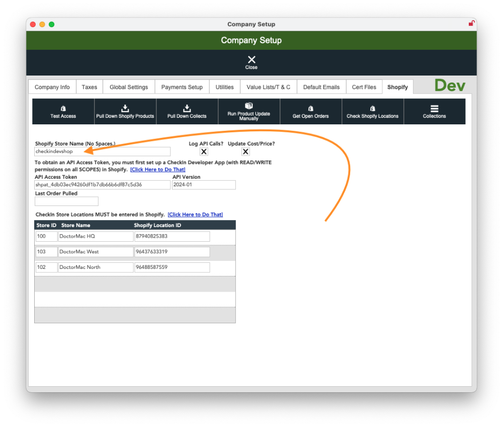

Next, navigate to the company setup screen. Insert your store name in the Shopify Store Name field, located in the Shopify tab.
Then, return to Shopify to continue the configuration.

  • Go back to CheckIn's Company Settings section and go to the Shopify tab. Paste the token into the API Access Token field.
  • Enter 2024-01 in the API version field. (see screenshot above for example)
  • If the Log API Calls checkbox is selected, click to uncheck it. This feature is used by the CheckIn development team to debug any issues that may arise with Shopify.
  • If you want the Cost and Price of Products updated in Shopify any time you change them in CheckIn, make sure the Update Cost/Price checkbox is checked.
  • Click on Test Access. Expand the pop-up box to see the full message. You should receive a pop-up with information about your store, such as the store name, address, etc. If you receive an error please contact Checkin Support.

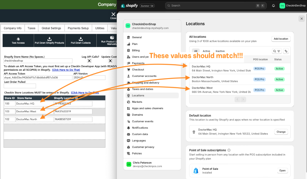

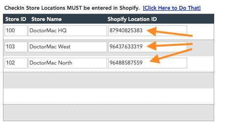

  • Next, ensure that each of your CheckIn Store Locations match the locations specified in Shopify by clicking on the Click Here To Do That button in CheckIn.
Make sure that you have a matching location in Shopify for each location you have in CheckIn.
Click on the Check Shopify Locations. If all is setup correctly, you will see that Shopify Location IDs are now present in CheckIn
Once all of that is populated, you have completed the first step of your Shopify Integration. Next, you will handle pulling down your products and activating your Shopify sync. Please reach out to CheckIn support before beginning the next step to ensure the pulldown is as smooth as possible.
