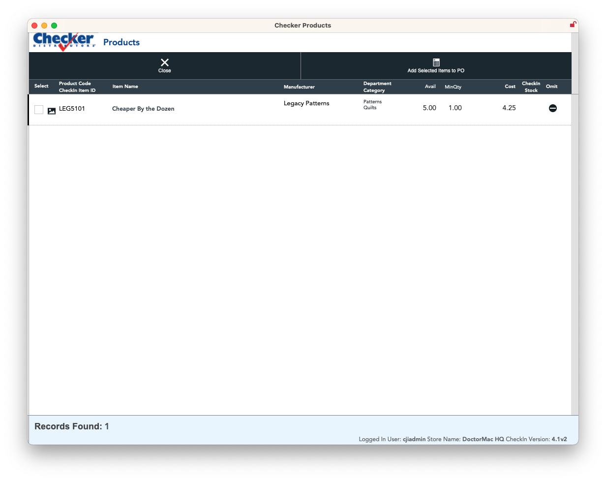

From the Purchase Order Dashboard, create a new PO.
Search for Checker via the Search Suppliers box on the PO. Once Checker is added to the PO, you can begin searching for products supplied by Checker.
Next, you can add Checker Products to the PO by using the New Product button or the Search Products button.
When using the New Product button, you will be able to enter the Checker Item Number and it will search the Checker API and if found, it will create the Product in the Checker table in CheckIn.
You will then have the option to Add the Product to YOUR CheckIn Inventory and to the PO. Simply click the Select OR click on the Item Name to add it to CheckIn and the PO.
