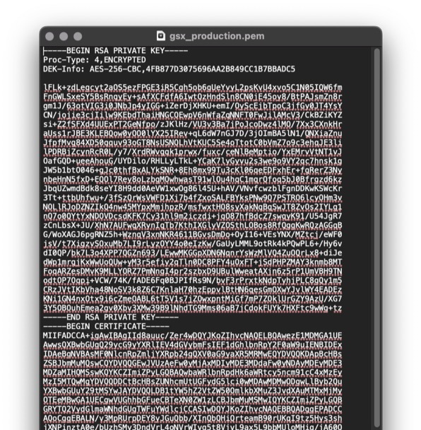

Once you receive a replacement file from Apple, follow these steps:
  1. Duplicate the file sent to you by Apple.
  2. Open both the duplicate file you've just created and privatekey.pem in TextEdit.
  3. Copy the contents of privatekey.pem and paste them at the top of the other file, above any content. You should have a file that looks like this.
  4. Save the file with the name gsx_production.pem. Make sure you save it as a PEM file, and nota TXT file.
  5. Move this file to System Library > FIleMaker Server > Data > GSX.
