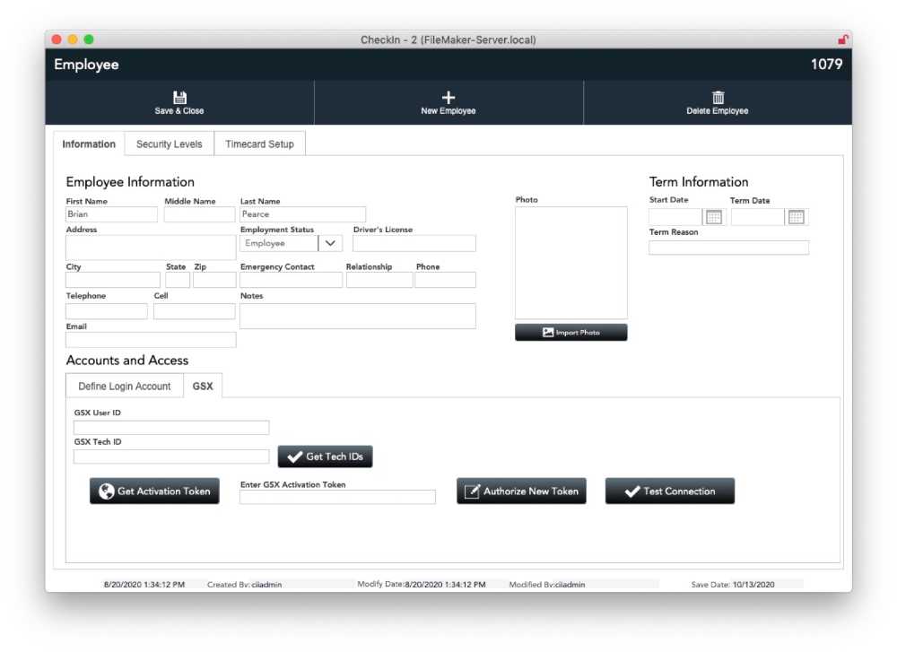

To add GSX Access for users in CheckIn: In the Taskbar, click the "More" button. Select "Admin," and then the "Employees" tab. Click on the triangle next to the employee. In the "Employee" window, select the "Information" tab, and then the "GSX" tab. Enter the Apple ID and Tech ID for the User.
Make sure the User is successfully logged into GSX on the web. Click the "Get Activation Token" button. Copy the token from GSX on the web, and paste it into the field next to the "Get Activation Token" button. Press the "Authorize New Token" button, and then the "Test Connection" button to confirm that GSX Access is working.
